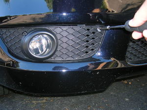

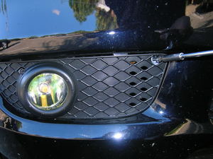

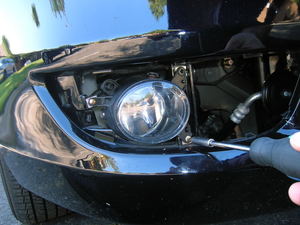

    2.) Unscrew the only visible screw on the outside of the housing.. the otherone that is kinda hidden is to level them.. DO NOT TOUCH THEM!!!! After the screw is off, pull on the grill and it will come right off
    3.) After having the grill off, proceed to unscrew the 3 screws holding the actual fog light housing.
    After this step, you may feel a lil bit dizzy and unstable.. thats completely understandable, you NEED beer... take a gulp and lets move on :D

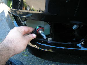

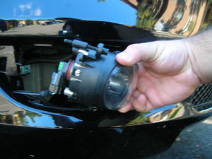

    4.) After feeling better, proceed to pull out gently the housing... as you can see, the cable doesnt have a lof of slack so be careful

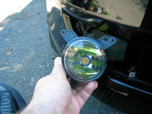

    5.) After you pull it out, take out the lamp gentle.. pull the plug gently pressing the clips.....

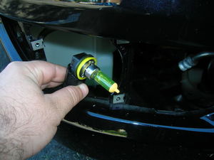

    6.) Then just plug your replacement... in my case, im using a 3000K Yellow TINTED lamp...
    7.) after that, hook the lamp back to the housing... mine looks like this after installing...

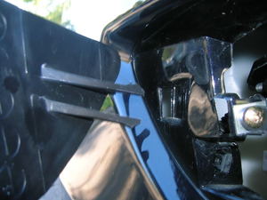

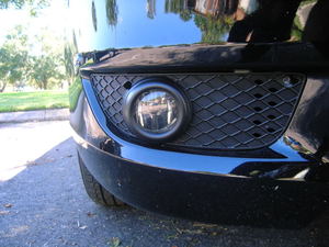

    9.) Now grab the grill.. this is very important because you can break it if you are not paying attention... you need to align the 2 prongs at the far end with the hole...
    10.) now close it and screw it back up...

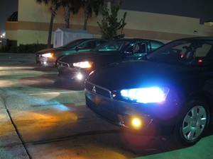

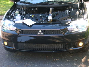

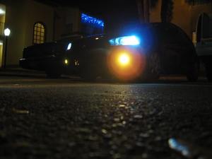

    This is how they like at 1pm with alota sunlight...

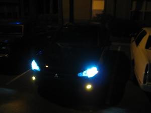

    this is how they look at night:
    autobot, farmer and lancerGTS have seen them so they can be the judges :)

    Ektor wicked write up dude.... just wanted to point out that you do not need to remove the entire fog light to replace the bulb. You only need to remove the black grill cover and that opens access to reach your hand behind the foglight. (only reason why i mention that is because its a pain in the a** to take out the screws that hold the light in place.
